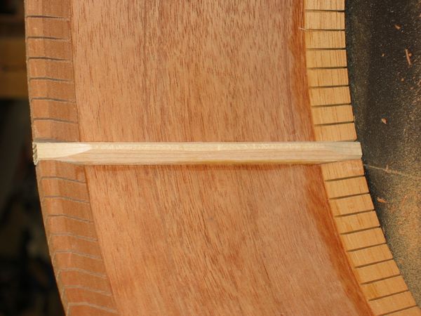

On my first build, a kit, my teacher insisted I use side braces through the kerfing. The photo shows my fairly feeble attempt. It was aggravating, but perhaps worth it.

If I were using side braces, I'd be sure to inlet them into the kerfing, to keep the ends from peeling up. Either that, or I'd shave them away to nothing, so they could flex with the side. I'm uncomfortable with the ones in Bill Greene's photo; perhaps wrongly so.
